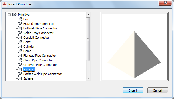

Insert Primitive dialog box
| If you want to… | then… |
| attach the primitive to an existing work plane | in the modeling area, select the work plane. |
| attach the primitive to the face of an existing primitive or modifier | press Enter, and, in the modeling area, select the face of the primitive or modifier.  Note: This creates a reference work plane on the selected face and attaches the primitive to the new plane.
To facilitate the selection of a plane or face, the software highlights the plane or face when you move the cursor over it.
Most of the primitives included with the software include multiple work planes. To select the current plane, do nothing. To cycle through the planes on the primitive and make another plane current, enter n (next), and press Enter. As you cycle through the planes, notice how the software repositions the primitive in the modeling area so the current plane on the primitive aligns with the selected plane on your part.
| flip the primitive so it is positioned on the other side of the plane to which it is being added | enter f (flip plane), and press Enter. |
| rotate the primitive around the center of the plane to which it is being added | enter r (rotate). Move the cursor and click to specify the angle change. Alternatively, you can enter the angle change on the command line and press Enter. |
| insert a mirror copy of the primitive instead | enter m (mirror), and press Enter. |
The software copies all of the modeling features in the primitive into your custom part. If the units in the drawing that defines the primitive do not match the units in your part drawing, the software also converts the units appropriately. You can now work with the part model as if you had created all of the features manually.

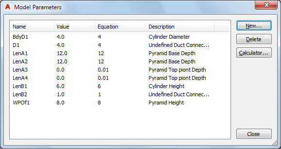

In the model parameters of your part, the descriptions of the parameters that were derived from a primitive include the name of the primitive. This makes it easier for you to differentiate parameters when you have added multiple primitives, or a mixture of primitives and manually added features, to the part model.
Model Parameters dialog box
