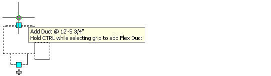

    draw duct directly from an MvPart select the MvPart and click the Add grip for the connection where you want to draw.
    draw duct from any point select the 1-Line tool on the Duct tool palette in the HVAC tool palette group.

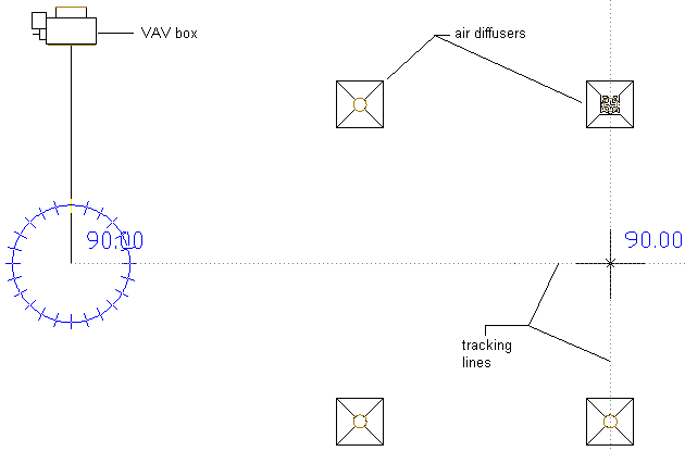

  5. Specify points to place the duct run.
    Drawing 1-line duct, top view
    Note: You can use AutoCAD MEP snaps and tracking lines to align duct geometry with other objects and to maintain connectivity between objects in the system.

  7. To insert 1-line duct fittings, use the 1-Line tool on the Fitting tool palette, and complete the 1-line layout for the system.
    Top view of a simple 1-line system: A VAV box is connected to 4 air diffusers.
