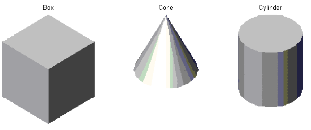

Primitives that represent basic shapes

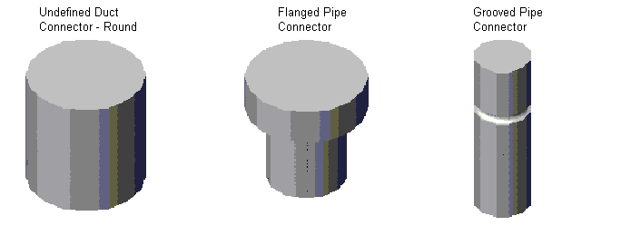

Primitives that represent part connections

Primitives that represent the connections on parts also include defined connections.
