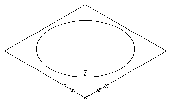

- To create the body of the tank, in the part browser, right-click XY Plane and click Add Profile
Circular. For more information about profiles, see Profiles.
- In the modeling area, specify a center point, enter 15" (381 mm) for the radius, and press Enter.
Tip: You can also enter an exact position such as 15,15 to specify the center point at the center of the workplane.
 A circular profile is created and is added to XY Plane in the part browser.

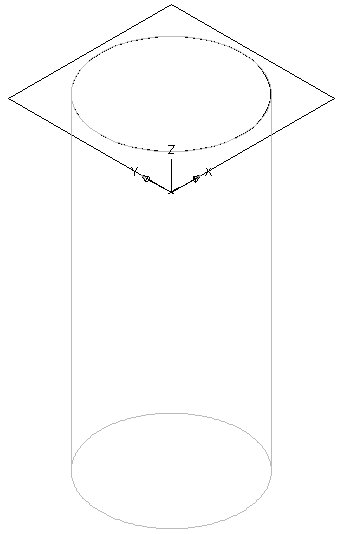

- In the part browser, right-click Modifiers and click Add Extrusion.
For more information about modifiers, see Modifiers.
- In the modeling area, select the circular profile.
The Extrusion Modifier dialog box is displayed.
- Under Termination, select Blind for Type, enter 60" (1524 mm) for Distance, and select Flip. Click OK.
A cylinder is created to represent the body of the tank and an extrusion modifier is added to Modifiers in the part browser.

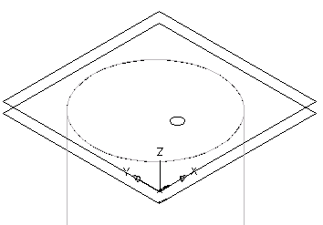

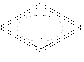

To model a tap
-  To create an offset work plane to help locate the tap, in the part browser, right-click Work Planes and click Add Work Plane.
The Create Work Plane dialog box is displayed.
- Click Offset and enter Tap Offset for Name. Click OK.
- Select the XY plane in the modeling area as the reference work plane, and enter 2" (51 mm) for the offset distance.
The tap offset work plane is created.

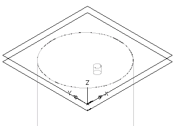

- To create the tap, in the part browser, right-click Tap Offset and click Add Profile
Circular.
- In the modeling area, specify a center point on the top of the tank, enter 1" (25 mm) for the radius, and press Enter.
A circular profile is created and is added to Tap Offset in the part browser.
- In the modeling area, select the circular profile for the tap.
- Under Termination, select Plane for Type and XY Plane for To. Click OK.
A cylinder is created to represent the tap, and an extrusion modifier is added to Modifiers in the part browser.
