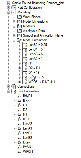

The model parameters of a parametric part define the default part size of the model and act as placeholders for the actual part sizes that you define later. In turn, the size parameters of the part define the actual part sizes. There is a direct connection between the model parameters and the size parameters. When you add a model parameter to the part model, the software adds a corresponding size parameter as well.
Model and size parameters of a round damper

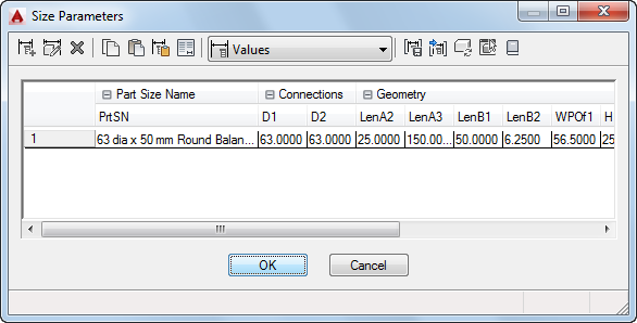

You define the part sizes of a parametric part by specifying values for the size parameters in the Size Parameters dialog box.
Size parameters of a round damper

-  Values. You use this mode to view and change the values of parameters when they are stored as lists, tables, and constants. You define multiple part sizes by entering multiple values for the size parameters. You can enter the values manually or copy and paste them from another part open in Content Builder, from a part open in Catalog Editor, or from a spreadsheet. For connector parameters, you can also insert the corresponding sizes for the segments used by default during layout.

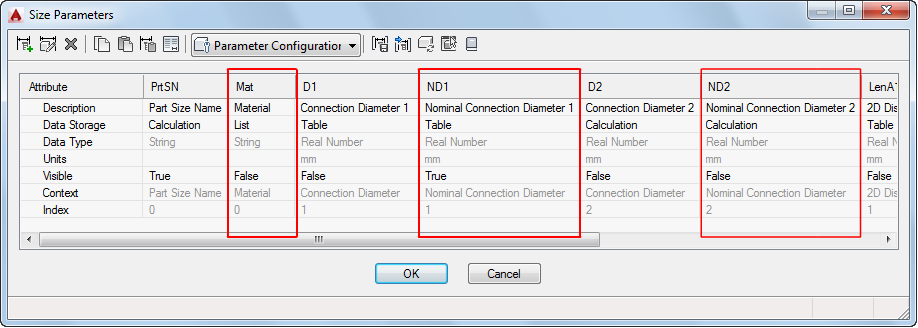

Size Parameters for Conduit
 The Size Parameters dialog box for conduit content has been updated to include separate dimensions for outside (nominal) diameter (ND1, ND2) and material (Mat), as shown next. In previous releases, only actual diameter (D1, D2), was available in Content Builder.
