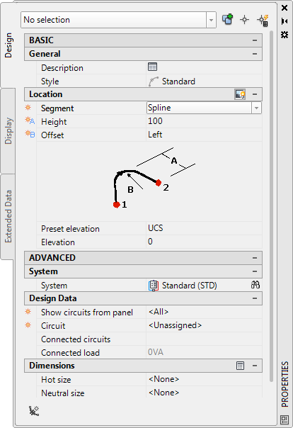

  2. On the Properties palette, if necessary, specify or change the wire to add by selecting a wire style:
    • Expand Basic, and expand General.
    • For Style, select a wire style.
      You can select from the wire styles in the current drawing.
    If you want to calculate wire sizes using the instant sizing tool, do not select the Standard style provided in the software. By default, that style does not specify a wire material, which is required to calculate the sizes.

  4. Expand Location, and for Segment, select the type of wire segment to use:
    If you want to use… then…
    Line select Line.
    Arc select Arc, and do the following:
    • For Height, enter the height of the geometry.
    • For Offset, select Left or Right, which indicates the side on which to display the geometry.
    Snake select Snake, and specify values for Height and Offset.
    Polyline select Polyline, and for Radius, enter a radius to set the curvature for the fillets.
    Chamfer select Chamfer, and specify values for Height and Offset.
    Spline select Spline, and specify values for Height and Offset.
    Tip: When drawing wires using arc, snake, or spline segments, you can override the values for Offset and for Height by specifying a point between 2 devices. This can be helpful when you want to route the wires around walls, equipment, or other floor plan geometry, or when you are unsure of the value to specify for Offset. For an example, see Example: Drawing Wires.

  6. Expand Advanced, expand System, and for System, select the system of the wire.
    Note: If the electrical connector on the device to which the wire will be connected does not have a specified system, you can connect a wire of any system to the connector. However, if the connector has a specified system, the system of the wire must be the same. If it is not the same, you cannot add the wire unless the system of the electrical connector is changed to match. Depending on how you have configured the connection rules, you are prompted to accept the change before adding the wire, the change is made without prompting you, or you cannot make the change and add the wire. The system of the device, which only determines how the device is displayed, is not affected. For more information about systems, see Configuring Electrical System Definitions and Working with Systems.
  7. Expand Design Data, and specify whether to assign the devices to a circuit as you connect them with wires:
    If you want to… then…
    connect the devices with wires without assigning a circuit for Circuit, select Unassigned.
    assign the devices to a circuit for Show circuits from panel, select the panel that contains the circuit. You can select from the panels in the current drawing, or in the electrical project database. Then, for Circuit, select the circuit.
    Attention: To use the instant sizing tool to calculate the wire sizes, you must select a circuit whose system type is Power and Lighting. You cannot select Unassigned or a circuit of different system type.
    Note: As you connect the devices with wires, the software assigns the devices to the specified circuit unless they are already assigned to one. In this case, the Circuit property cannot be changed. You can manually create a multiple-branch circuit by changing the specified circuit as you add wires, or by drawing a wire between 2 devices that are already assigned to different circuits.
  8. Expand Dimensions, and specify the wire sizes by doing one of the following:
    • On the Dimensions bar, click to have the instant sizing tool calculate the sizes.
      The tool calculates the sizes based on
      • The material and temperature rating of the wire, which are specified in the wire style
      • The rating of the specified Power and Lighting circuit
      • The ambient temperature specified in the drawing. For information about specifying the ambient temperature, see Configuring Circuiting Options.
    • Select or enter wire sizes for the hot, neutral, ground, and isolated ground wires.
    The wires for which you need to calculate or specify sizes depend on the design specifications of the selected wire style.
