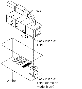

Use a standard naming convention that represents the part family as you save the symbol as a block. For example, the symbol block for a roof-mounted air handling unit for a commercial building, with an outlet size of 24 x 24 inches, could be named AHU Commercial Roof 24x24 symbol.
 Tip: Name the symbol block “symbol” to have Content Builder by default use the symbol block as the source for generating the 3D symbol.

- Under Base Point, click the Pick Point option and select the block insertion point.
The insertion point, or base point, is used as a reference for positioning the block.
