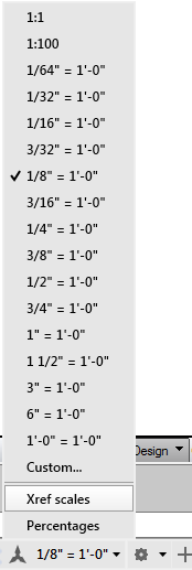

To set the current annotation scale
  1. To set the annotation scale for model space, change to the Model tab. To set the annotation scale for a viewport in paper space, select the viewport.
  2. On the drawing window status bar, click the current annotation scale, and select a new scale from the flyout menu.
