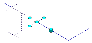

| rotate the symbol, in its current isoplane, in 90-degree increments around its base point | click a Rotation grip as many times as needed. |

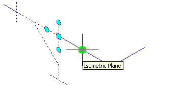

| change the isoplane (left, top, and right) of the symbol | click the Isometric plane grip as many times as needed. |
In the top isoplane, before rotation
In the top isoplane, after 180 degree rotation
In the left isoplane, before isometric plane rotation
