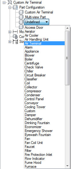

- To specify the part type, right-click Undefined, and click Edit.
- Select Air Terminal for the part type.
The predefined types are dependent on the selected part domain.
Example of part browser for air terminal
- To specify the part subtype, right-click Undefined, and click Edit.
- Select Diffuser for the part subtype.
The list of predefined subtypes is dependent on the selected type.
