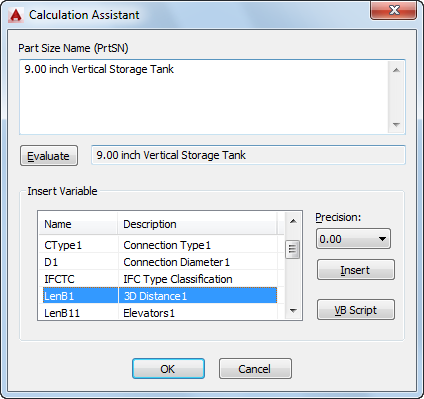

- To specify a unique part size name, in the Size Parameters dialog box, select Calculations from the list.
The calculation strings are displayed.
- Double-click PrtD in row 1.
The Calculation Assistant dialog box is displayed.
- In the Calculation Assistant dialog box, define the part size name.
- Under Precision, select 0.
- Under Insert Variable, select LenB1, and click Insert (to the right).
- At the top of the dialog box, click the value for Part Size Name (PrtSN), and enter inch Vertical Storage Tank.
- Click Evaluate to see the result.
Calculation Assistant dialog box showing values entered
- Click OK twice.
