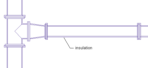

Insulation is only visible when piping is displayed as 2-line. When you activate this feature, insulation is added to all pipe system definitions as you draw pipe. A new pipe or pipe fitting inherits the insulation values from the existing pipe or pipe fitting where it was added.
Note: Insulation is an annotation element that shows where insulation is used on a pipe system. Because it is not an object, you can only modify how and where it displays in the drawing. However, you cannot create schedules for insulation.
