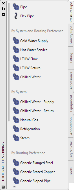

Use pressure pipe tools in non-sloped piping designs.
Pressure Pipe tab

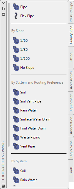

Use gravity pipe tools in sloped piping designs.
Gravity Pipe tab
