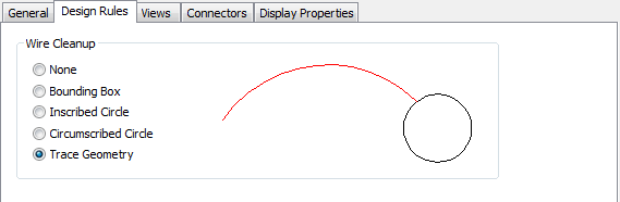

  3. Click the Design Rules tab.
  4. For Wire Cleanup, select a wire cleanup method.
    This selection determines how wires are displayed when connected to panels. The preview image on the right provides an example of the current selection.
