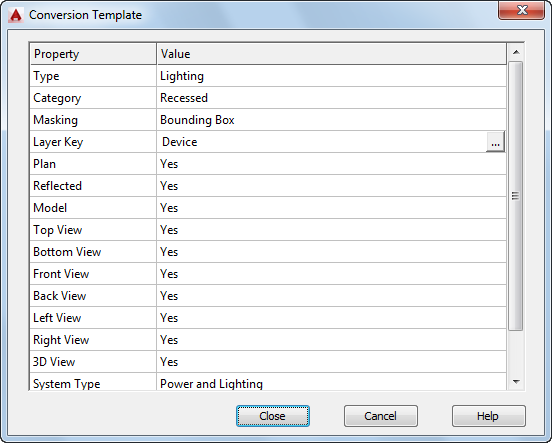

| create a template | click Create. In the Open File box, specify the location for the new template, and, for File name, enter its name. Click Save. In the Conversion Template dialog box, specify the values of the template settings. Click Close to return to the Device Conversion Script dialog box. |
| use an existing template | click Browse. In the Open File box, select the existing template, and click Open. Note: To make changes to the template prior to using it, click Edit. In the Conversion Template dialog box, modify the values of the template settings. Click Close to return to the Device Conversion Script dialog box.
