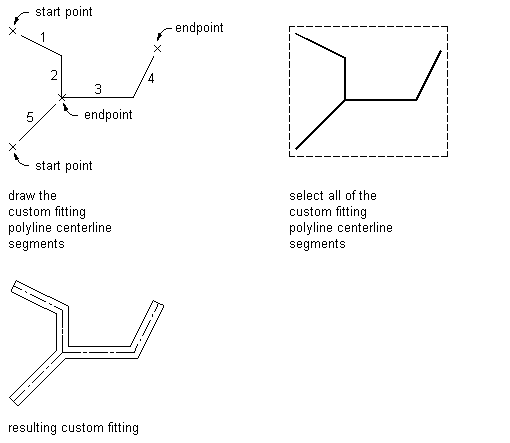

- Draw the centerlines with lines, polylines, or arcs.
Typically, the centerline is drawn connecting ductwork and can be any combination of AutoCAD lines, arcs, or polylines. See the next illustration.
Defining a custom fitting polyline centerline
 Note: If you draw linework from endpoints of an existing duct, the shape and size of the duct is inherited by the end segment of the fitting that you create.
