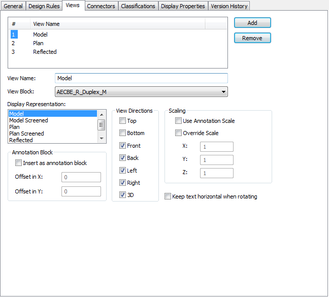

  2. Create the style, as described in Creating Styles.
  3. In the left pane of Style Manager, navigate to the style, select it, and click the Views tab.
    Views tab for an existing device style
  4. To add a view:
    • Click Add.
    • For View Name, enter a name, such as Plan or Model.
    • For View Block, select a block to represent the view.
      You can select from the AutoCAD blocks defined in the current drawing.
      Note: Each MvPart creates a unique view block based on the style name and view direction that is retained when inserted into a drawing.
  5. Specify when to use the selected view:
    • For Display Representation, select the display representation in which to display the view.
    • For View Directions, select one or more view directions in which to display the view.
    Tip: To determine the view block to use to display a style-based object, the software identifies the active display representation (determined by the active display configuration) and the active view direction in the current drawing, and then searches for a view of the style that has the same specified display representation and view direction. If a matching view is found, the associated view block is used to display the object. If multiple matches are found, all of them are used to display the object. If no match is found, the object is not displayed.
  6. If you want the view block to be inserted as an annotation block, select Insert as annotation block.
    If desired, you can offset the annotation block from its insertion point by specifying values for Offset in X and for Offset in Y.
    Note: When you insert a view block as an annotation block, the Annotation display component for the object type (device, panel, or plumbing fitting) determines its display properties, such as its color, linetype, and lineweight.
    By defining multiple views with the same specified display representation and view directions, you can display an object using annotative and non-annotative view blocks at the same time, and you can configure the display properties of the view blocks differently. For example, you might have a junction box style that requires a view block to represent the symbology, and a second view block to represent the annotation. This allows you to define the appearance of the annotation view block by configuring the Annotation display component for the junction box, and to define the appearance of the symbol by configuring the other display components for the junction box.
    Remember: See Defining the Views of a Style.
