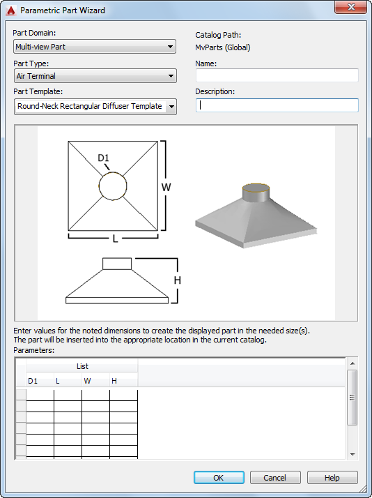

  1. Click Home tabBuild panelTools drop-downParametric Part Wizard..
  2. Parametric Part Wizard
  3. For Part Domain, select the domain of the catalog that contains the part template you want to use.
    You specify a catalog for a domain in the Options dialog box. For more information, see Specifying Default Part Catalogs and Style-Based Content Locations.
  4. For Part Type, select the part type of the template whose shape resembles the part you want to create.
  5. For Part Template, select the name of the part template whose shape resembles the part you want to create.
    Note: The lists of choices for Part Domain, for Part Type, and for Part Template are filtered to include only those for which there are defined part templates.
  6. For Name, enter a name for the new part.
    The part name is used to name the XML file that defines the part. It is also displayed when the part is opened in Content Builder or Catalog Editor.
  7. For Description, enter a description for the new part.
    Users select parts by description in add dialogs and modify dialogs. The description is also used to create the names of the part sizes.
  8. Under Parameters, enter values for the size parameters shown in the part image.
    The values are used to create the list of part sizes. To enter a value in a cell, double-click the cell, and then enter the value. To access the Copy, Paste, and Clear commands, right-click the cell.

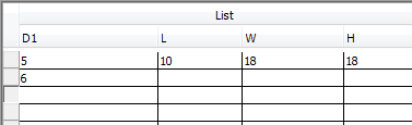

    As an example of the latter, the following image shows the values for a custom round-neck diffuser. The values result in 2 part sizes, each with different values for the diameter of the neck.
    Example of Parameters showing values for custom round-neck diffuser
