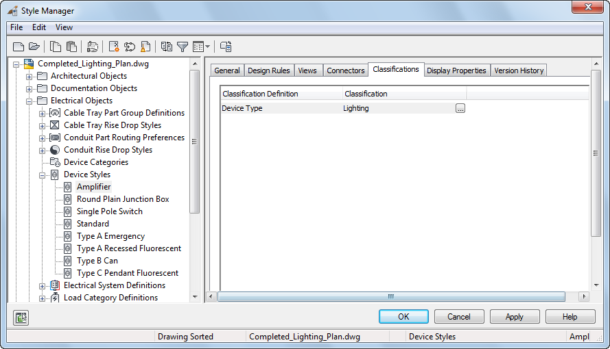

Classification definitions that apply to devices are displayed on the Classifications tab of each device style. When configuring a device style, this is where you specify a classification for the Device Type classification definition and for any custom classification definitions. Most of the device styles included with the software specify a classification for the Device Type classification definition.
Classifications tab of a 12 x 24 Recessed device style

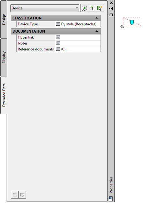

Because a device in a drawing is an instance of a device style, the device has a property for each classification definition in the device style. On the Extended Data tab of the Properties palette, you can view or override the classification for one or more devices in the drawing.
Properties palette for a selected 12 x 24 recessed light

  3. Click the Classifications tab.
  4. Specify a classification for the Device Type classification definition:
    • Click beside the Device Type classification.
    • In the Select Classification dialog box, under Device Type, select a classification.
      Note: Keep the classification for the Device Type classification definition the same as the value for Type unless you have added a custom classification that is more appropriate.
    • Click OK.
