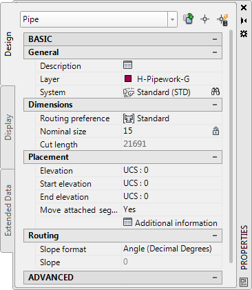

Defines the properties on the Design tab of the Properties palette to use to modify the piping system.
The Design tab is divided into two sections: Basic and Advanced.
Basic properties are expanded by default. The properties display the last stored value.
General | Description |
Description |
Describes the object (optional) |
Layer |
Specifies the layer style for the selected object |
System |
Specifies the system definition for the selected object |
Dimensions | Description |
Routing preference |
Specifies the routing preference for the selected pipe object |
Nominal size |
Specifies the size in the routing preference for the selected object |
Size lock |
Prevents the editing of the nominal size value while you are modifying the pipe routing |
Cut length |
Specifies the reported value of the length of the pipe |
Placement | Description |
Elevation |
Specifies the elevation of the pipe object |
Start elevation End elevation |
Specifies the elevation at the starting and ending points of the pipe segment ![]() Start/end elevation on Properties palette |
Move attached segments |
Lets you specify whether to move the attached pipe segments if the location of the selected part has changed (default — Yes) |
Additional information |
Click |
Routing | Description |
*Slope format |
Displays the current slope format (not editable) |
*Slope |
Specifies the slope value of the current pipe segment (not editable) |
