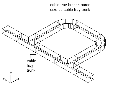

Drawing a branch
Connecting a cable tray run to a cable tray trunk that is the same size
To add a cable tray or conduit branch
