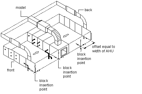

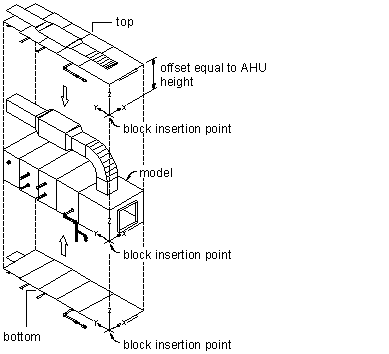

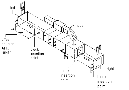

Each part size represents a real-world building systems part, such as a piece of equipment, that has different representations in different views. In the block-based building environment, 2-dimensional (2D) orthographic view blocks can be generated from the 3D model of the part size. Standard AutoCAD® blocks representing the plan, elevation, and model views of a part are grouped together to create an individual part size. Typically, each part size has 6 orthographic view blocks: 1 for each view direction (top, bottom, front, back, left, right). The following illustrations represent the 6 orthographic view blocks for an air handling unit.
Top and bottom orthographic view blocks
Front and back orthographic view blocks
Left and right orthographic view blocks
The insertion point, or base point, is used as a reference for positioning the block upon insertion. All view blocks share a common insertion point of 0,0,0 in the world coordinate system (WCS) that reflects the same point on the model block. The location of the insertion point directly affects the placement of the part size when you add it to your drawing.
The previous illustrations show the insertion point of the model view as the right corner of the bottom edge of the front side. The top and bottom views have an insertion point at the right corner of the front edge, with the top-view insertion point offset by the height of the air handling unit. The front and back views have an insertion point at the right corner of the bottom edge, with the back-view insertion point offset by the width of the air handling unit. The left and right views have an insertion point at the bottom-front corner, with the left-view insertion point offset by the length of the air handling unit.
