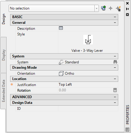

If necessary, scroll to display the tool. Because tools contain pre-configured properties for the objects they create, you might not need or be able to specify some of the schematic symbol properties referenced in this procedure.
| If you want to select a schematic symbol style… | then… |
| in the current drawing | expand Basic, and expand General. For Style, select the style. |
| in a drawing in the directory specified as the default content location for schematic symbols, or in the style drawing referenced in the properties of a tool you selected | on the General bar, click |
You can select from the systems in the current drawing.
You can select either the insertion point of the view block that represents the symbol, or one of 9 other points on the device, such as Top Left or Middle Center.
You can add the ID to your diagram as a label. The label style that you select when you add the label determines the font and size of the ID.
If you specify a point on a schematic line, the symbol breaks into and aligns with the line. It then behaves like an in-line symbol.
Alternatively, to accept the default rotation, press Enter.
You can also modify the properties on the palette, and then add additional symbols.
