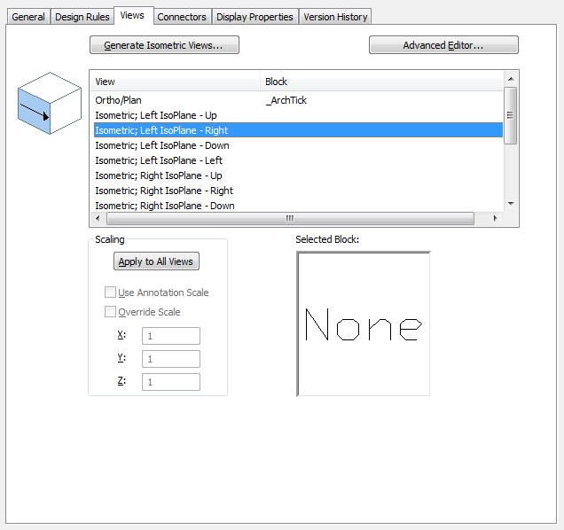

  2. Create the style, as described in Creating Styles.
  3. In the left pane of Style Manager, navigate to the style, select it, and click the Views tab.
    Views tab for an existing schematic symbol style
  4. Click Generate Isometric Views.
