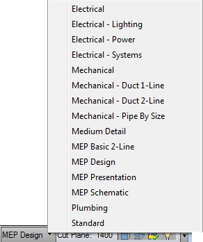

To change the current display configuration
  1. Click the current display configuration in the Drawing Window status bar.
    The displays included with the drawing are listed.
    Default display configurations included in the Aecb Model drawing template
  2. Select a display configuration from the list.
