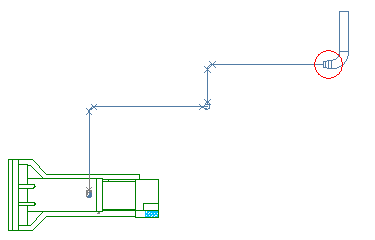

  1. Select a duct.
    Shows duct segment selected in a run

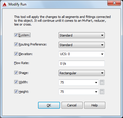

  2. Click Duct tab Modify panelModify Run.
  3. In the Modify Run dialog box, select one or more properties (system, routing preference, elevation, flow rate, shape, width, height), and then specify the change from the corresponding list.
    Modify Run dialog box (for duct)

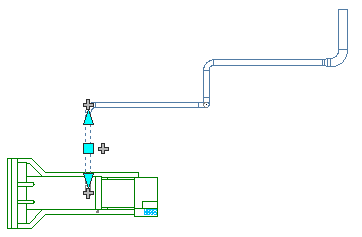

    The dialog box displays the current settings for the selected object. Changes made affect similar objects in the run up to an MvPart, reducer, tee, or cross.
    Shows changes to routing preferences and system up to reducer (circled)
