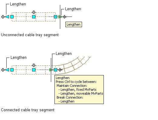

You can modify the length of cable tray and conduit segments using Lengthen grips (
 ). Because the grips constrain a segment to its current angle, they are particularly useful for modifying the lengths of runs you have already placed.
When you use the Lengthen grip on an end connected to another object, you must specify whether you want AutoCAD MEP to maintain connectivity between the objects when you modify the length.
Cable tray segments with activated grips

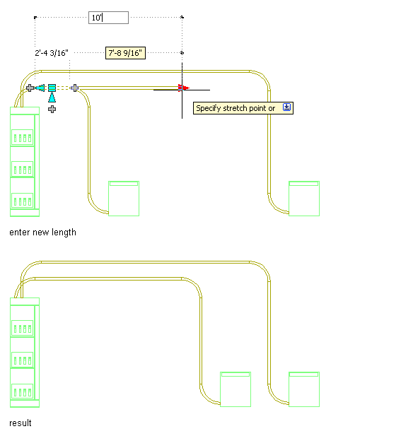

| specify the new total length | press Tab to activate the input field for specifying the resulting dimension, and enter the new length. Press Enter. |
| specify the difference between the current length and new length | Drag the cursor to begin lengthening or shortening the segment, and enter the change in length in the input field that is active by default. Press Enter. |

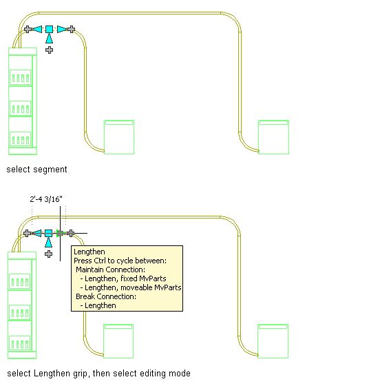

The following example illustrates how to modify the length of a conduit segment. A horizontal conduit segment is stretched to the right. Because the modification occurs in the moveable MvParts editing mode, connected objects including parts are adjusted to maintain their connectivity. More specifically, the vertical conduit, connected fittings, and the transformer are moved.
Lengthening conduit
