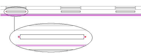

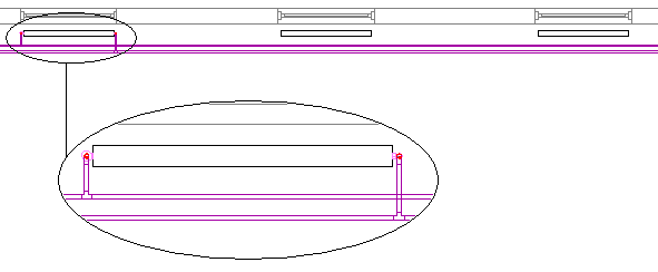

After you have placed the radiators in your drawing, use this procedure to create the parallel pipework for a radiator system.
- Add the parallel pipes for the radiator supply and return. See Adding Parallel Pipes to a Radiant Heating System.
- Add valves to the connectors on a typical radiator. See Adding Radiator Valves.
- Add branch pipes to connect the valves to the supply and return pipes. See Connecting to Existing Pipe and Connecting a Pipe Run to an MvPart.
- Copy the valves and branch pipe layout to similar radiators to connect them to parallel pipes. See Connecting Multiple Radiators.
