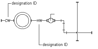

When you draw a schematic line, you can select a designation for the line on the Properties palette. The designation is a text ID that helps you to identify the line in the layout. The style you select for the line determines the list of designation IDs from which you can choose; you can select an ID from the list or enter a different one.
Example designation IDs

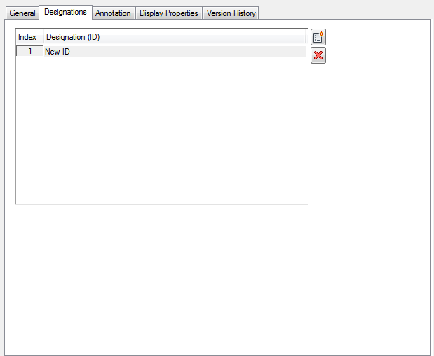

To define designations for a schematic line style
| If you want to… | then… |
| add a designation | click |
| edit a designation | click the corresponding Designation field, edit the ID, and press Enter. |
| delete a designation | select a designation, and click |
