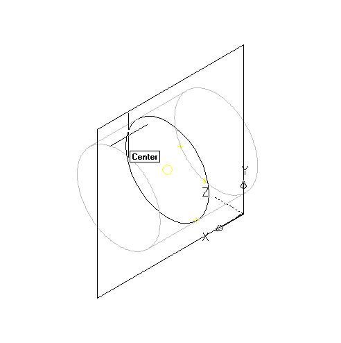

- In the part browser, right-click ZX Plane and click Add Profile
Circular. The circular profile defines the diameter of a fitting, such as an elbow, and the connectors. You can add more geometry lines and circular profiles for more complex graphics.
- Using object snaps with center mode enabled, select the center of the circular profile of the trunk, and enter 6" (152 mm) for the radius.

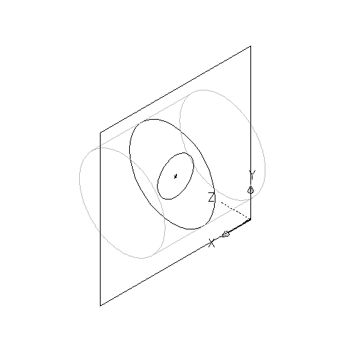

A circular profile is created and is added to ZX Plane in the part browser.

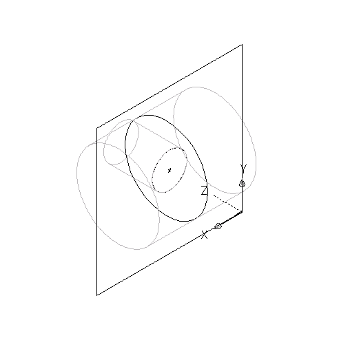

A cylinder is created to represent the branch of the transitional tee and a second extrusion modifier is added to Modifiers in the part browser.

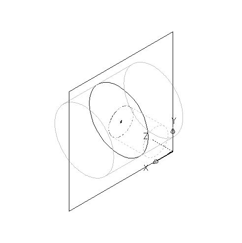

- To flip the branch to the other side of the trunk, expand Modifiers in the part browser, right-click the second (branch) extrusion modifier and click Edit.
The Extrusion Modifier dialog box appears.
- Under Termination, select Flip and click OK.
The branch is flipped to the other side of the trunk.
