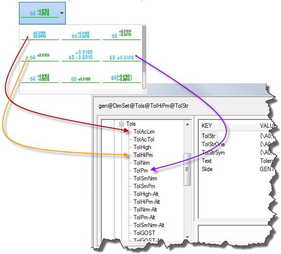

The thumbnails of tolerances in the Tolerance drop-down correspond to the first eight entries under Acad/M > DimSet > Tols, in the System Editor. The names of these entries begin with “Tol” (for example, TolHigh). The remaining entries refer to the alternative unit representation of tolerances; their names end with “-Alt.” For example, TolHigh-Alt is the alternative unit representation of TolHigh.
System Editor entry mappings to tolerance representations
The entries under Acad/M DimSet Tols, from top to bottom, correspond to the tolerance representations in the list, from left to right.

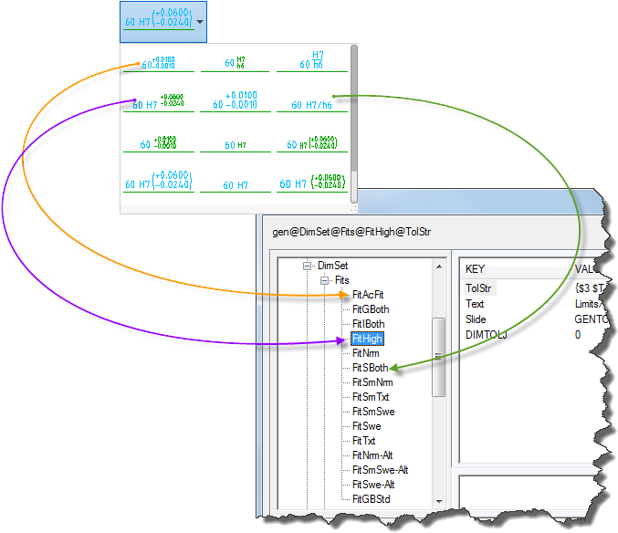

Like tolerances, the 12 representation in the list in the Fit Representations dialog box correspond to the first 11 entries under Acad/M > DimSet > Fits in the System Editor. The names of these entries begin with “Fit” (for example, FitNrm). The remaining entries refer to the alternative unit representation of fits; their names end with “-Alt.” For example, FitNrm -Alt, is the alternative unit representation of FitNrm.
System Editor entry mappings to fit representations
The entries under Acad/M DimSet Fits, from top to bottom, correspond to the tolerance representations in the Fit Representation list, from left to right.

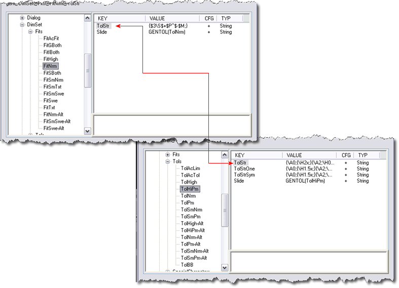

The keys for the entries below “Fits” and “Tols”
The keys for the entries below “Fits” and “Tols” are the same, regardless of whether the entry is for a fit or a tolerance.
The keys and the values they contain are:
Slide
Contains the name of the graphic to show on the button face. This usually is the name of a slide file (*.sld) created with the MSLIDE command.
Text
Contains the text for the button caption.
TolStr
Contains the tolerance expression. Usually a combination of MTEXT format codes and special characters.
TolStrSym
Contains the tolerance expression to use for symmetric tolerances, where the tolerance is expressed in the form ±; 9.9999 . If this key does not exist, the system follows TolStr.
TolStrOne
Contains the tolerance expression to use for one-sided tolerances. If this key does not exist, the system follows TolStr.
TolStrNeg
Contains the tolerance expression to use for one-sided tolerances where the non-zero tolerance is negative. If this key does not exist, the system follows TolStrOne.
DIM___
Contains a numeric value to use for setting an AutoCAD dimension variable that has the same name as this key.

  1. Example of an expression for a fit
    $T {\H0.7x;$2 \A0;\S$+$P^$-$M;}
    $T
    Fit symbol, “lc3”in this case. No formatting information is appended to this special character, so it has the same height as the dimension text.
    Opening brace, begins parentheses to apply format codes to the text within parentheses.
    \H0.7x;
    Sets the text height to 0.7 times the height of dimension text.
    $2
    Sets the text color to the color defined for small text.
    \A0;
    Sets the vertical alignment to bottom.
    \S
    Sets the upper deviation ($+$P) to be stacked on top of the lower ($-$M) deviation. The expression “\S$+$P^$-$M;” (using “\S” in combination with the caret character "^" and the semicolon character “;”) maps to the form \Snnnn^mmm;.
    The plus (+) sign in the upper deviation.
    $P
    The value of the upper deviation.
    The minus (-) sign in the lower deviation.
    $M
    The value of the lower deviation.
    Closing brace, closes parentheses to apply format codes to the text between parentheses.
