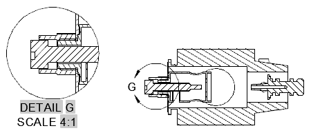

Smooth with border
Displays a border around detail views and sets the cut lines on the models shown in detail views to be smooth.
applied to model documentation detail views applied to AMDETAIL detail views

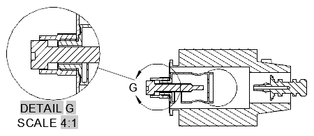

Smooth with connection line
Displays a connection line between the detail border and the detail view boundary. Additionally, displays a border around detail views and sets the cut lines on the models shown in detail views to be smooth.

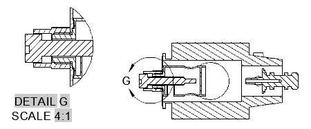

Jagged
Sets the cut lines on the models in detail views to be jagged.
Note: AMDETAIL detail views do not support jagged cut lines. When this option is selected, AMDETAIL drawing views behave as though the Smooth option is selected.
