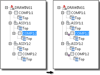

Example of a reference component
This example shows a drawing that contains two instances of the assembly ASSY1; ASSY1:1 and ASSY1:2. COMP1 occurs within ASSY1 (COMP1:2) and outside as well (COMP1:1). If you select COMP1:2 in ASSY1:1 and make it a reference component, COMP1:2 in ASSY1:2 also becomes a reference component. This is because the instance COMP1:2 occurs twice, once in ASSY1:1 and once in ASSY1:2. However, the instance COMP1:1 does not become a reference component.
