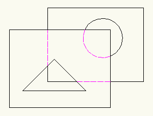

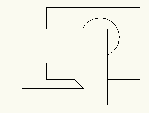

Display hidden lines
Sets the hide style of hidden lines to dashed lines (enabled by default). Clear this check box to make hidden lines invisible.
Effects of the Display hidden lines check box
In this example, the Display hidden lines check box is selected.
In this example, the Display hidden lines check box is cleared.
