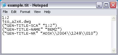

A standard import (.tit) file is a text file containing drawing border and title block information, which can be imported by the AMTITLE command.
Rather than manually selecting drawing borders, scale, and title block attributes while executing the AMTITLE command, *.tit files give you the ability to predefine these settings and automatically pick them up.
The following example shows the file structure.
The first two lines of the file must contain the following:
Use the remaining lines, which are optional, to map attributes from the drawing title block to the appropriate associated text, for example:
Such a text file can look like:
