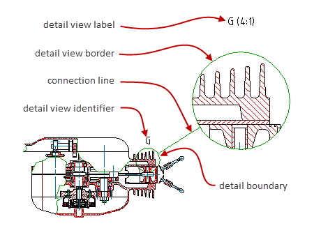

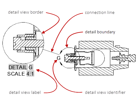

About Detail View Styles in AutoCAD Mechanical
A detail view style is a named collection of settings that control the appearance of detail boundaries, identifiers, and labels of detail views.
