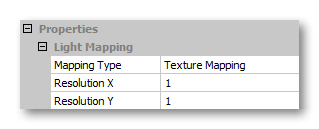

Light Mapping
The settings in the Light Mapping group control the way lighting values are stored
in lightmaps for the different objects in your scene.
| setting |
description |
savable? |
| Mapping Type |
Determines how the lightmap for this shape instance is baked.
- None disables the baking of lightmaps for this shape instance.
- If you choose vertex mapping, no other settings are read from this group.
- If you choose texture mapping, you can use the Resolution X and Resolution Y settings
to tweak the resolution of the texture.
Yes |
| Resolution X |
Sets the resolution of the lightmap on the X axis. Read only when the Mapping Type
setting is set to Texture Mapping.
Yes |
| Resolution Y |
Sets the resolution of the lightmap on the Y axis. Read only when the Mapping Type
Yes |
