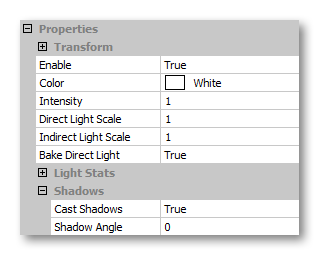

Properties for Directional Lights
This page describes the configuration settings exposed for directional lights in the
eRnsT interface.
| setting |
description |
savable? |
| Transform |
The properties in the Transform group define the position, orientation and scaling
of the light source along each axis. These values are expressed in world space.
Yes |
| Enable |
Determines whether or not the light is active. You can use this setting to disable
a light temporarily if you want to test the effect of removing the light from the
scene without permanently deleting it.
No |
| Color |
Determines the color of the light radiated from the light source. The value you set
here is also affected by the Intensity setting.
Yes |
| Intensity |
Determines the intensity of the light radiated from the light source. The default value of 1 produces light at the full value of the Color setting. Lower
values dampen the strength of the color proportionately, and higher values push the
color toward white. A value of 0 effectively disables the light source.
Yes |
| Direct Light Scale |
Applies a scaling factor to the strength of the direct light rays emanating from the
light source. You can use this setting to tweak the strength of the direct light relative
to the indirect light.
Yes |
| Indirect Light Scale |
Applies a scaling factor to the strength of the indirect light rays emanating from
the light source. You can use this setting to tweak the strength of the indirect light
relative to the direct light.
Yes |
| Bake Direct Light |
Determines whether or not the direct light from this source is baked to the lightmap.
If you set this value to false, the direct light component is rendered in the 3D view
using real-time shadow mapping. Indirect light from the source is always baked to
the lightmap.
No |
Light Stats
The settings in the Light Stats group determine when the light source contributes
to the overall lighting.
| setting |
description |
savable? |
| Visible for Eye |
Determines whether or not the light source gives a direct light contribution. |
Yes |
| Visible for Refl |
Determines whether or not the light contributes to rays that have been reflected.
Yes |
| Visible for Refr |
Determines whether or not the light contributes to rays that have been refracted.
Yes |
| Visible for GI |
Determines whether or not this source contributes to the indirect light in the scene.
Yes |
Shadows
The settings in the Shadows group control whether or not the light casts shadows,
and how those shadows are calculated.
| setting |
description |
savable? |
| Cast Shadows |
Determines whether or not the direct light from this source casts shadows when it
hits physical objects in the scene.
Yes |
| Shadow Angle |
Specifies the angle at which the soft edge of a shadow will spread as it is cast from
an occluding physical object. You can also think of this setting as the angle of sky
taken up by this light source. Larger values produce more diffuse shadows, smaller
values produce sharper shadows.
Yes |
