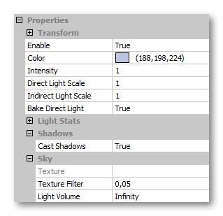

Properties for Sky Lights
This page describes the configuration settings exposed for sky lights in the eRnsT
interface.

Sky
The settings in the Sky group set properties specific to sky lights.
| setting |
description |
savable? |
| Texture |
Displays the file name of the texture set up for this light source, if any. This value
is read-only; textures can only be assigned to sky lights using the Beast API.
No |
| Texture Filter |
Determines the size of the texture filter for this light. You can tweak this setting
to control the amount of blurring applied to the texture, which can reduce noise in
the lightmaps.
Yes |
| Light Volume |
Specifies the spatial volume of the light source.
- Infinite floods the entire scene with light.
- Box or Sphere limits the light generated by this source to a volume whose extents
are determined by the scaling values set for this light source under the Transform
group.
Yes |
