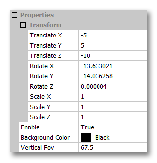

This page describes the configuration settings exposed for cameras in the eRnsT interface.
| setting | description | savable? |
| Transform | The properties in the Transform group define the position, orientation and scaling of the camera along each axis. These values are expressed in world space. | Yes |
| Enable | This setting has no effect for cameras. | No |
| Background Color | Determines the color used to render any areas visible to the camera that are not bounded by any geometry or sky lights. | No |
| Vertical Fov | Determines the vertical field of view of the camera, in degrees. | Yes |
