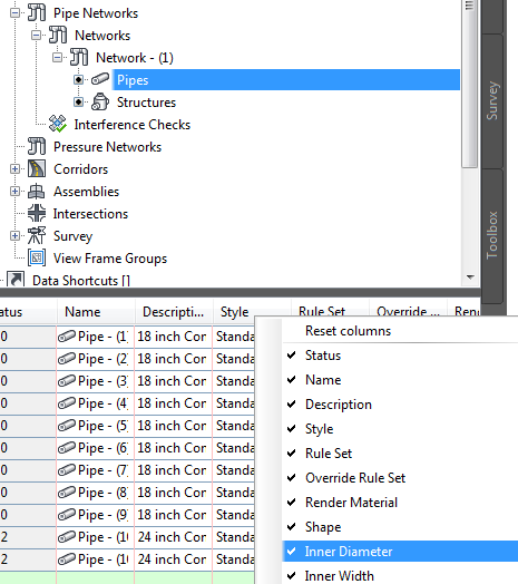

Right-click a collection on the Prospector tab to batch change properties such as style, rule, or render material.
Figure 3: Edit styles in the item view
You can quickly edit the styles of many pipes or structures in the Prospector tab for that pipe network as shown in figure 3.
To bulk edit pipes or structures
