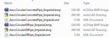

When pipe networks are created or edited, AutoCAD Civil 3D references the parts catalog for information about each part (pipe or structure). You can use the Part Builder utility to edit the data for any part, and to expand the catalog by creating additional custom parts. As shown in figure 1, each part is defined by three files with the same root name but different extensions:
Figure 1: Catalog files for two types of circular pipe
If you use Part Builder to modify a part, you will probably change the XML file, as it contains the detailed dimensions and calculations. Changes to the DWG and BMP files are possible, but not essential in every case.
