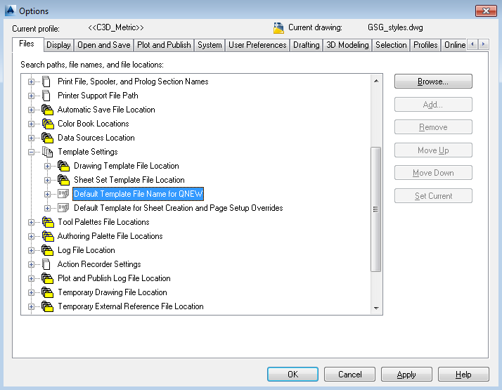

To change the default template
Figure 1: Set the default template
