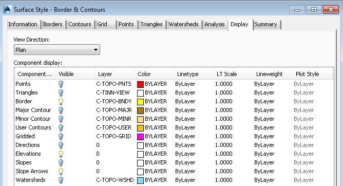

In the Surface Style - Existing Ground Contours dialog box, the Border, Major Contour, and Minor Contour components are set to visible. These components determine how the surface appears in the drawing. With these components enabled, the surface is displayed as shown in figure 6.

  1. On the Toolspace Settings tab, expand the Surface styles collection and double-click the Existing Ground Contours style.
  2. On the Display tab, click the light bulb icons to turn off the Major Contour and Minor Contour components.
  3. Click the light bulb icons to turn on the visibility for the Elevations and Slope Arrows components as shown in figure 7. Keep the Border contour set to Visible.
    Figure 7: Enable the elevations and slopes components
Now the drawing displays borders, elevation differences indicated by color, and slope direction arrows and appears as shown in figure 8. The contour lines are no longer visible. These changes now reflect the components that are enabled for the supplied Finish Grade surface style.
