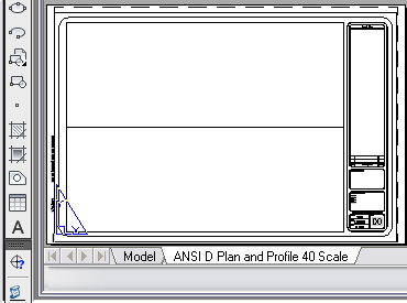

Add Scale Factor to Layout Name
When naming the layouts that you use in plan production templates, you may find it useful to add the scale factor that was used in the viewports to the layout name. The following illustration shows an example of a layout name that includes the scale factor used in the viewport—ANSI D Plan and Profile 40 Scale.
Figure 18: Layout name that includes the scale factor
