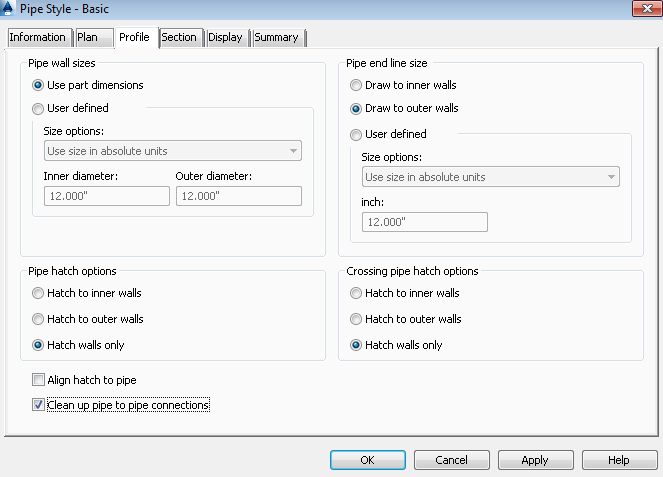

Use the Clean Up Pipe To Pipe Connections option in the Pipe Style dialog box, as shown in figure 4, to improve the appearance of pipe profiles so that the pipes graphically appear to line up as expected. This option is not enabled by the default, so you must select it.
To enable pipe clean up
Figure 4: Dialog box for selecting pipe connection clean up
