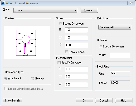

  1. Maximize current.dwg, and click Insert Tab Reference panel Attach . In the Select Reference File dialog box, navigate to source.dwg, select it and click Open.
  2. In the External Reference dialog box, set Insertion Point to 0,0,0, Scale to 1,1,1, and Rotation Angle to 0.
    It is recommended that you set the Path Type to Relative Path.
    Figure 15: Required settings for Xref labeling
  3. Click OK.

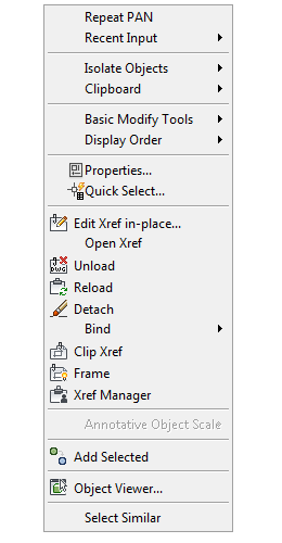

  5. Select and right-click the xref parcels and observe the xref commands that are available.
    Note:
    The xref data is highlighted with dashed lines when selected. The xref commands affect the corresponding labels in various ways. If you detach or bind the xref, the label is deleted and must be recreated.

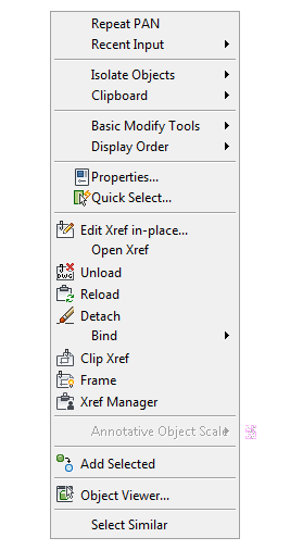

  6. Right-click a parcel that exists in the current drawing and note the context menu as shown in figure 16.
    Figure 16: Xref object context menu
