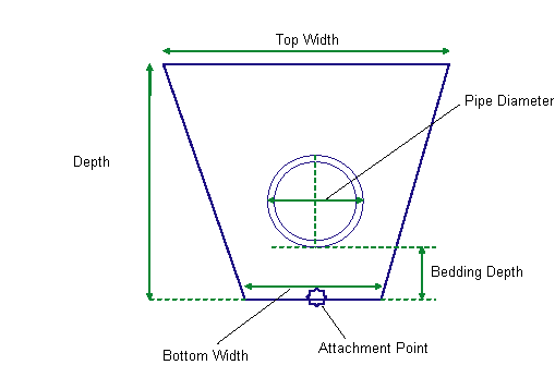

TrenchWithPipe
This subassembly creates a stone-filled drain structure with a circular pipe inside.
The attachment point for this subassembly can be at the bottom center, the top center, or the top corner of the drain structure.

The subassembly builds the shape for a simple drain structure as shown in the above illustration.
