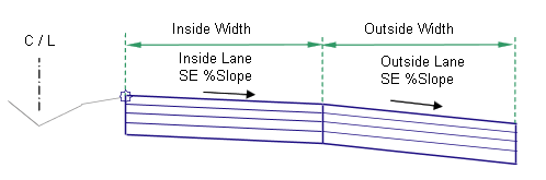

This subassembly creates a cross-sectional representation of travel lanes for a broken-back roadway, where the inside and outside lanes have different downward slopes.
This subassembly is used for the inside lanes on divided, broken-back highways. The pavement structure follows the standards described in “Pavement Structure on Paved Sections” in the AutoCAD Civil 3D User’s Guide Help.
The attachment point is at the inside edge of lane on the finish grade surface. This component can be attached to either the left or right side.
Note: All dimensions are in meters or feet unless otherwise noted. All slopes are in run-over-rise form (for example, 4 : 1) unless indicated as a percent slope with a “%” sign.

This subassembly creates a set of inside lanes and outside lanes that may have different slopes. The inside lanes are inserted outwards from the attachment point using the Inside Lane superelevation slope. If the superelevation is not defined at a station, the Inside Default %Slope value is used. The outside lanes are inserted outward from the end of the inside lanes, using the outside lane superelevation slope, or the Outside Default %Slope.
If an offset horizontal alignment name is assigned to the Width during corridor modeling, the width of the lane will vary to match the offset of the alignment.
In layout mode, this subassembly displays the finish, base, and subbase links for the given widths and depths at the default % slopes.
