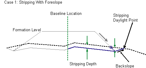

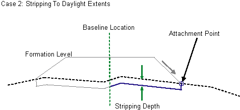

This subassembly inserts parallel links defining the bottom of the stripping layer below a specified surface. If the option to extend stripping to the existing ground with a backslope is set to No, then stripping starts at the attachment point directly on the specified surface, with a vertical link with depth value specified in the input parameters. From the bottom of this vertical link, a series of links parallel to the specified surface are introduced inwards, until the baseline location of the assembly. If the option to extend stripping to the existing ground is set to Yes, then at the attachment point, a link is introduced with the specified foreslope, until the elevation difference between the bottom of this new link and the specified existing ground is equal to the “stripping depth”. From this point, a series of links parallel to the specified surface are introduced inwards, until the baseline location of the assembly. Additionally, another link outwardly is added to daylight to existing ground.

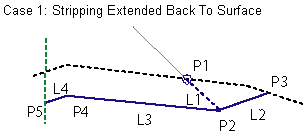

If the option to extend the stripping link to a surface is selected, then a foreslope link with a specified slope value to the stripping depth is inserted first, and then the horizontal link is added, as explained previously. Also, a backslope link is added outward, from the outside bottom of the stripping link with a specified foreslope, and to the elevation equal to the subassembly attachment point.

Point/Link Codes Description
P3 Daylight_Strip (Only for Case 1) Daylight point of stripping backslope link
L1 Foreslope_Stripping (Only for case 1) Stripping foreslope link defining backfill
L2, L3, L4… Ln Stripping Stripping links
